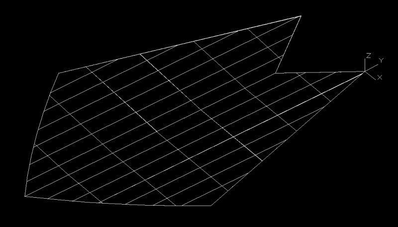

How to surface odd shaped 3D geometry with a single entity?
I'm new to surfacing (3Dface, region, loft)
Is there a way to surface this geometry with a single surface entity?
I had to use 2 lofts to "surface it" instead of region due to lines being non-coplanar with the arc (in other words top most corner is higher than the other adjacent 3 corners).
Can I ask why it would be necessary?
Psychological thing. Not critical at all, but I'd like to know if it's possible or not.
Yes, I think it could definitely be done.
Just finished this before you posted your drawing.
Is this kind of what you had in mind?
Yeah, assuming some of your contour geometry isn't co-planar. What is that surface and how did you do it?
I first created it as a solid then used the Solid-to-Surface feature of AutoCAD.
