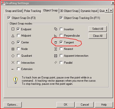

Dadgad Posted June 26, 2012 Posted June 26, 2012 Welcome to the forum. Use the REGEN command, if it really is tangential and just looks like it isn't. Use the TANGENT OSNAP when drawing a tangential line. You can also access the TANGENT osnap in the SHIFT+right click contextual snap menu mid command. Quote
MSasu Posted June 26, 2012 Posted June 26, 2012 Did you used Tangent Osnap mode? Probably is just a visualization problem - try to call REGEN command and see if is fixed. Quote
trilok2047 Posted June 26, 2012 Author Posted June 26, 2012 ya, i used tangent osnaps, but if i zoom in in a large extent i see that the line is separate from circle... i tried using regen also bt it didn't work....... Quote
