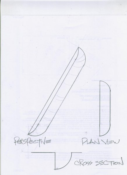

I'm working on a model of a car with an internal louver - the louver goes into the hood, rather than protruding out from it. I can make it using straight lines but that is not authentic, it is rounded. I've tried using arcs from the shapes, attempting to follow the straight line route but can't get anything to work. Help, please! Thanks.

Is this similar to what you are attempting to create?

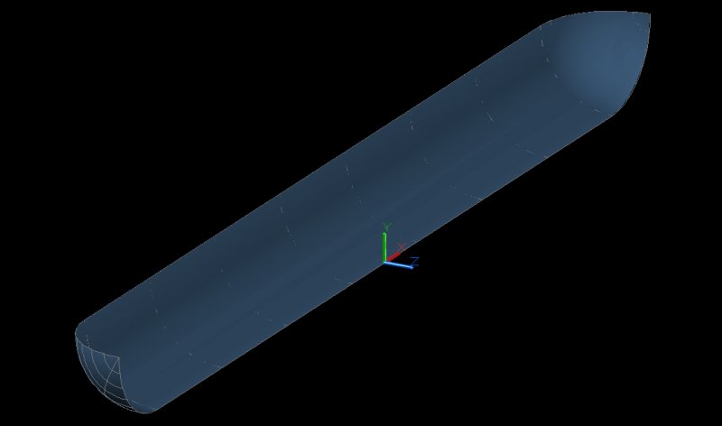

I could barely describe the convoluted way I made it in AutoCAD let alone describe how to do it in a program I have never used.
Basically I created a solid tube with rounded ends. Sliced it lengthwise, exploded what was left (thus creating surfaces), erased what I didn't want. Result as shown.

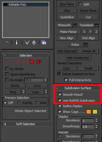

I would probably build something like that as a normal editable poly and then check the "Use NURMS Subdivision" box to smooth it out. Or you could just apply a Turbosmooth modifier.
Check out the attached file to see what I did.

PElgin: See, I told you someone ^ ^ ^ smarter than me might read and respond to your question. Aren't you glad you waited?
