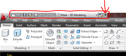

In AutoCAD at least there is a drop-down menu option on the QAT (Quick Access Toolbar) at the top left-hand corner of the screen.
If there is no option for a "Classic" style in MEP there should still be a way to get toolbars to display onscreen. I know it can be done in AutoCAD.
I've circled the QAT. The arrow points to the feature that enables a drop-down menu to appear with additional commands that can be added to the QAT.
