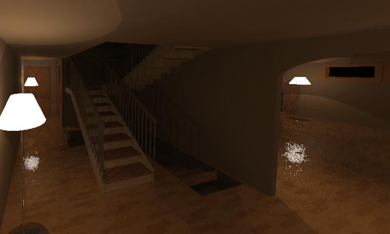

I have a question about lighting when I render a scene. There are light spots in the scene and I cant really get rid of them no matter what I seem to do at this point.
I was wondering if anyone knew what I am doing wrong or what I can do to get rid of them.
I am going to try and attach a scene and I hope they attachFirst Floor Stairs Entry.jpgYou can see the spots on the floor.

Those are reflections. Adjust the reflectivity of your floor material.
Thank You, that makes sense. I hate to ask, but would yall be able to explain in short as to how to do this. I would highly appreciate it.
Thank You again.
What version are you using?
Manage Tab > Materials > (Floor Material) > Then in the options on the right will be reflections
I am using Revit Arch 2012. I will give that a shot. Will it also work with objects as well. Such as furniture and appliances?
It works on the material level. So any object the material is applied to, will present the properties you set.
To change other objects, select the objet and "Edit Type". Take note of the material it's using, then edit that material. Duplicate the material if it's used for more than one type of object.
FWIW - I usually set floors 0-2% reflections.
