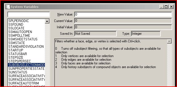

You may want to check your SUBOBJECTSELECTIONMODE variable setting, as explained in the image.
I'm guessing that you would want to set it to 0, which is how I tested it, and I believe the default setting.
Enter SUBOBJECTSELECTION at your commandline and check your current system variable setting, if need be, change it to 0. :)
