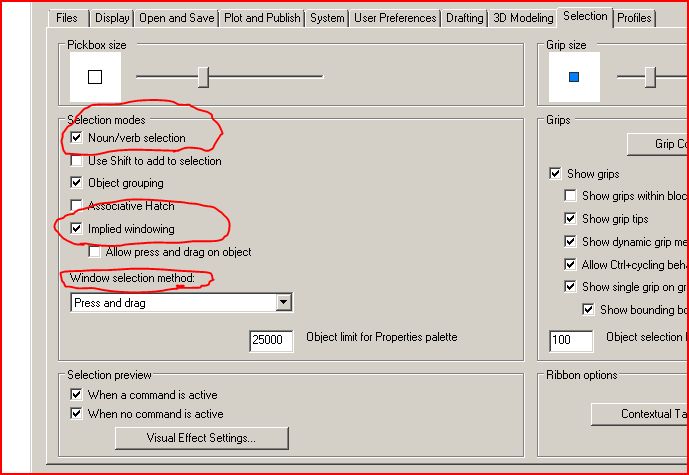

I was working normally in a drawing (ACAD 2012, 32b) file when, without any apparent reason, I tried to delete something and it didn't work. The way I work is that I select first and then press the "delete" key.
Now, when I do this, absolutely nothing happens. The objects remain selected. While trying to figure out what was happening, I discovered further disruptions. For example, when I select and object and then right-click, instead of showing me the edit shortcut menu, it repeats the last command. I know what you are thinking, but I already verified the right-click customizations and it is correctly set to "shortcut menu" in the "edit mode".
Finally, when I double click on a text, it won't edit as expected; again, nothing happens. Ane yes, in "Options/Windows standard behaviour" the "Double click editing" options is selected.
All the above has it's way around: the "erase" command works, the "ddedit" text works, etc. But it slows me down horribly.
I have no idea if this is really an ACAD problem, a Windows 7 problem, or even a mouse problem, but on other software such as MS office, keyboard and mouse work properly.
Thanks,
Did you take a look at the SELECTION tab in OPTIONS?
Either your WINDOW SELECTION method, or NOUN/VERB selection seem likely candidates.
Or SHORTCUT MENUS in drawing area?
Do you want to turn ON your time sensitive Right Click Customization, I always use it.
One million thank-yous Dadgad. I set it up as you show and back to normal.
