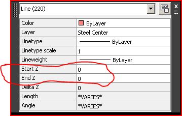

Try turning on your QUICK PROPERTIES, which you can do at the bottom of your screen, left of center, second icon from the right, or enter QUICKPROPERTIES
at the commandline.
SET your VIEW to TOP.
Select everything on your screen, or at least ALL of the lines which you want to flatten.
Select lines from the QUICK PROPERTIES drop down list, and set your Z start and Z end points to zero, like in the image, then hit ENTER.
That should do it.
