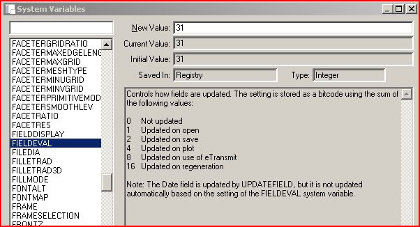

I work for a company that does sewer main design and am looking for a way to take X and Y coordinates from the modelspace (for the centre of the manholes) and automatically update a table with these coordinates. This is to eliminate the risk of the table not being properly updated manually when small changes are made to the design.
Does anyone know a way that i could do this? At my old job, we used an add-in that allowed for the extraction of coordinates into a tag reference, so i suppose this is similar.

I think the answer is already in thread's title - just look for FIELD command. Use Object as Field name, select the desired entity (Object type) and indicate Position as Property.

Thanks for the quick response. I am aware that this will geive me the coordinates i require, however i am wondering if it is possible to seperate the coordinates (X and Y) and put them in seperate columns in a table, with them still auto updating. Sorry for not making myself clearer in the first place.
This is possible - you may define two different fields linked to the same entity for that purpose - for first retain X coordinate, respectively Y for the second one. Check this setting in bottom-right side of field setup dialog.
OK excellent i'll give that a try. Thanks again. Do you know if it is possible to put a field in paperspace linked to an object in modelspace? I can't seem to do it.
I don't know either if this is possible. I did a quick test and seems that can create the field, but it isn't updated; maybe someone with much experience will provide an answer.
An alternative solution is to create the table with locations in Model and show it in Layout trough a dedicated viewport.

You want to look at the attached image which will help you to understand field updating, as controlled with the FIELDEVAL system variable.
Yes you can create a field in paperspace which will access data from modelspace.
