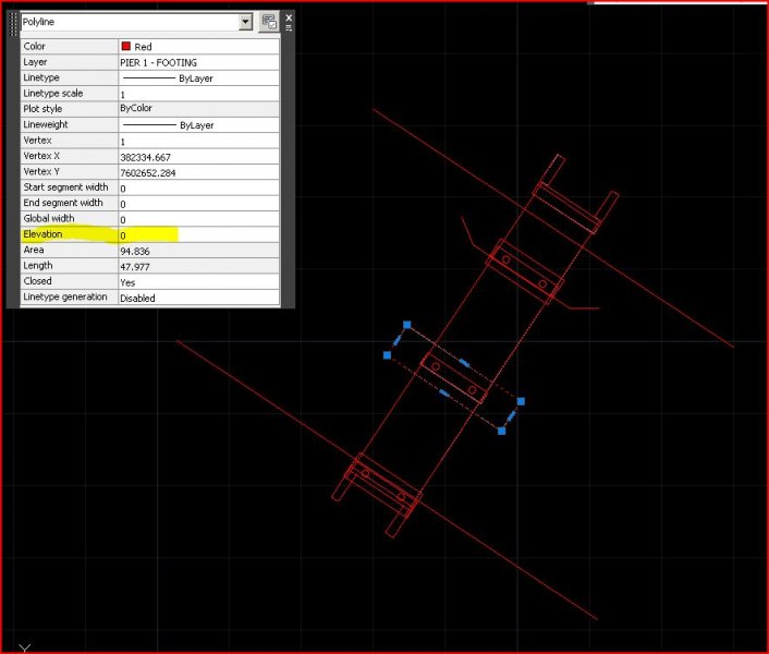

Here you go, So basically juring the job, we were instructed that the asbuilts would be needed in pdf format, so we recorded our survey data, i'm an engineering surveyor. Then they decided they also wanted dxf, So i used our pdf'f to draft the x and y positions, now i want to change the z values to what they are in reality.........

You can change the elevations of these polylines in your QUICK PROPERTIES or PROPERTIES.
The attached image show my QUICK PROPERTIES displaying relevant information for the selected polyline.
As these are polylines they are all coplanar on the XY axii.
If they are meant to have one elevation for each polyline, then you can just edit the information highlighted in yellow for the elevation of each object.
This is not the sort of work I normally do, there are plenty of folks working in similar fields on the forum, but it may just be that simple.
I hope that helps you.
You can turn on your quick properties in your right click shortcut menu, or at the bottom center of your screen, second icon from the right.

Thank you for your help, the issue is that I have to have individual elevations for each corner of the footings etc, so I have tried to explode the polylines etc, but still having trouble. I have even tried to insert points with elevations at the corners......
Basically when I export this to a dxf, the designers need to be able to "id" any corner and get an x,y,z value.
thanks for your help so far, hopefully someone else will post, when I go to my properties, I have x y and z tabs, when I selact z a little calculator appears, when I select this it brings me to "quick Calc" so I enter the elevation I want here but the apply button always stays gray, not allowing me to alter the z value.

I think that you are getting in a muddle with Elevations and Z values.
There is a polyline in your drawing that has a Z value of 0, but an elevation of -9999.999. Only the Z value shows up when you ID a point.
Another matter to consider is that a polyline can only have a single Z value. If your lines have differing Z values, then you will have to use a 3D polyline. If you have the original data, then perhaps re-drawing it in 3D will be better.
After you have set all the ELEVATIONS to 0, then I favour the old fashioned MOVE instead of altering the Z values.

If your comparing as built to design why not have two seperate dwgs design & as built the "as built" should be 3d real survey levels as a mimimum 3d points x,y,z lots of examples here how to load. The points can be combined say on another layer in the design dwg leave the design at 0.0 turn on points DDPTYPE set the points to a size not % its pretty obvious what des v's as built. You can do plines etc but the more info the harder to compare.
