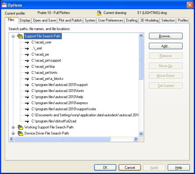

yrnomad Posted July 3, 2012 Posted July 3, 2012 I just finished configuring a new system for a user, that is a Windows 7 - 64bit, with AutoCAD 2012. Most of the rest of us are using Windows XP with AutoCAD 2010. We have about 20 Lisp routines that we load via the Startup Suite, and I've loaded each into his Startup Suit, and shut down autocad and restarted. When I try to execute one of the routines that should have loaded via the startup suite, I get an unknown command response. Any ideas? Quote

yrnomad Posted July 6, 2012 Author Posted July 6, 2012 Well, I've stripped the Startup Suite loads out of my AutoCAD 2010 (on Windows XP) and I no longer get any of my typical routines loaded. Here is my support path: The AcadDoc.lsp is in the C:\ACAD_PE\Support folder, so it is high up in the search path. I've even tried putting a copy of that TempLisp.lsp in the Acad_PE folder named AcadTempLisp.lsp and it's not picking them up. Our Acad2010.lsp & Acad2012.lsp are the ones that come with the install located in the C:\Program Files\AutoCAD 2010\Support folder. Any ideas what else to check. Quote

Lee Mac Posted July 7, 2012 Posted July 7, 2012 Ensure that you have only one ACADDOC.lsp file, and that AutoCAD can find it. To check, open a new drawing and type at the command line: (findfile "ACADDOC.lsp") If this returns a valid filepath, ensure that the filepath points to the ACADDOC.lsp that you wish to load. If the above returns nil, AutoCAD cannot find the ACADDOC.lsp file. Also, how are you loading the programs in the ACADDOC.lsp? Using the load function? autoload function? Or do each of the programs reside in the ACADDOC.lsp? Quote
yrnomad Posted July 9, 2012 Author Posted July 9, 2012 Ah, got it figured out. one of the setvar was crashing the rest of the loads... Thanks everyone for your help! Lee Mac - What is the difference between doing a load, and an autoload function? Quote
