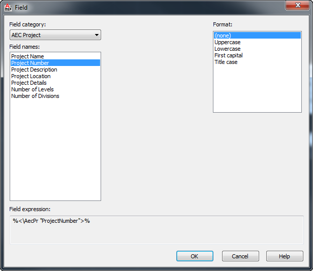

Lee Roy Posted July 9, 2012 Posted July 9, 2012 I'm looking to do an If/Then for a list of AEC Project Numbers. However, I can't find the AEC Project Number field to create the list. I'm stuck before I start. Help? Thank you. Quote

Lee Roy Posted July 9, 2012 Author Posted July 9, 2012 When I insert the field into a document, the "Field expression" is %%. -EDIT- That's what I'm looking for. I don't know how to put that Field expression into a lisp. Quote
BlackBox Posted July 9, 2012 Posted July 9, 2012 (edited) When I insert the field into a document, the "Field expression" is %%. -EDIT- That's what I'm looking for. I don't know how to put that Field expression into a lisp. Why didn't you say so in the first place! (vl-load-com) (defun c:FOO (/ ss) (prompt "\nSelect text entity to replace \"TextString\" with AEC Project Number: ") (if (setq ss (ssget ":S:E:L" '((0 . "TEXT,MTEXT")))) (vla-put-textstring (vlax-ename->vla-object (ssname ss 0) ) "%<\AecPr \"ProjectNumber\">%" ) ) ) Edited July 9, 2012 by BlackBox Quote

BlackBox Posted July 9, 2012 Posted July 9, 2012 (edited) You can either pull from the eName's DXF 1, or the Vla-Object's TextString Property. I'd personally use the latter, as I would also be sure to incorporate a FieldCode validation first; example: (defun _GetTextStringIf (oText fieldCode) (if (= fieldCode (vla-fieldcode oText)) (vla-get-textstring oText) ) ) (defun c:FOO (/ ss v) (if (and (setq ss (ssget ":S:E:L" '((0 . "TEXT,MTEXT")))) (setq v (vlax-ename->vla-object (ssname ss 0))) ) (prompt (_GetTextStringIf v "%<[b][color=red]\[/color][/b]\AecPr \"ProjectNumber\">%")) ) (princ) ) Edited July 9, 2012 by BlackBox _GetTextStringIf simplified Quote
BlackBox Posted July 9, 2012 Posted July 9, 2012 I get "bad argument type: stringp nil" Sorry about that, I neglected the double-backslash required (i.e., "\\"), which represents the single-backslash "\" within the FieldCode String. See the revised code in my earlier post here. Quote
Lee Roy Posted July 9, 2012 Author Posted July 9, 2012 Cool, that's working. Now how do we get it to pull that value without clicking on a field? I've got millions of things running through mind, so i'm trying to explain this as best as I can... So that when you run the command, it automatically pulls the value from the activedocument. I want my function (think acaddoc) to assign "plotstyle1" by default except when the activedocument's ProjectNumber (%%) matches a specific value (ie "1000.00") in which case it assigns "plotstyle2". I don't want to have to click anything. I really appreciate your help! Quote
