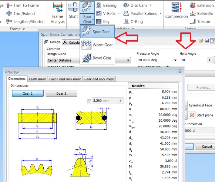

Is this for 2D or 3D?
Is this just for show or for manufacture?
If you are a student you can download Autodesk Inventor for FREE 3-yr student learning license.
There is a gear generator in Inventor that makes this much easier.
