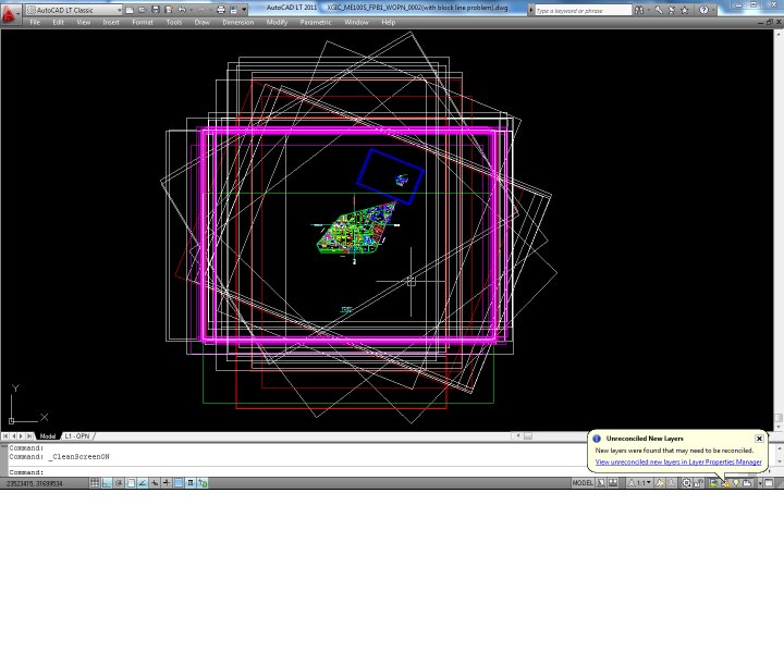

Hi,
in one of my XREF files, a lot of lines of which i believe are the outlines for the blocks, suddenly appear in my drawing. The funny thing is when i open the xref, the file dissapears. any ideas?

post a screen shot of what you see I am not seeing anylines that shouldnt be there ?
sparkyuk,
here's the attached picture of the problem i'm encountering.
Funny thing is when i tried to convert the dwg to pdf, the lines disappears. Perhaps that could give you some clues..
I am not seing those lines at all, I did notice you haveUnreconciled new Layers might pay to sort that out see if it cures it ?
They look a bit like image frames.
Check your IMAGEFRAME value in both drawings, try setting it to 0 in the destination xref to see if they disappear, and to 1 or 2 in the xref to see if they appear.
Check your references dialogue box to see if you have references (probably pictures) that it can't find.
or do you mean the lines disappear?
I can't download the file. That site is probably blocked. So, I can't be sure about this but those look like they might be proxy object bounding boxes. You may need object enablers.
+1
That's what I was thinking.

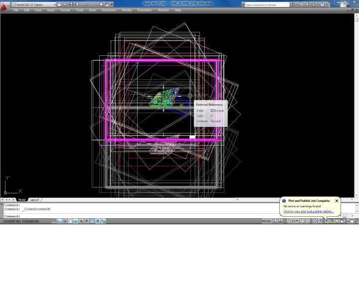

Can i send the acad files through email instead, if anyone would be so kind? The files are to big to be uploaded here..
Thank you

I doubt that's the issue, as it was only that particular dwg that have such problems when i Xref the archi background. all the other drawings work perfectly.
In any case, what to do regarding this Object Enablers? I have no clue what its all about. All i know is that I've set the options to auto-check for any enablers online.
has it got anything to do with me using Autocad LT?
Please post one of the XREF files since that is where the problem is.
