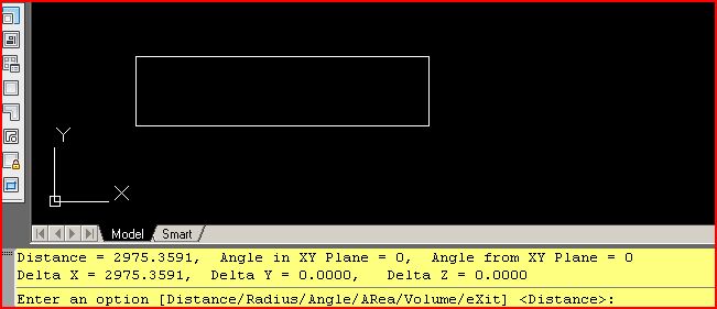

nestly Posted July 14, 2012 Posted July 14, 2012 Can you post the text from the text window (F2) when you're trying to use MEASUREGEOM or DIST commands Command: _MEASUREGEOM Enter an option [Distance/Radius/Angle/ARea/Volume] <Distance>: _distance Specify first point: Specify second point or [Multiple points]: Distance = 0'-3 43/64", Angle in XY Plane = 0.00000000, Angle from XY Plane = 0.00000000 Delta X = 0'-3 43/64", Delta Y = 0'-0", Delta Z = 0'-0" Enter an option [Distance/Radius/Angle/ARea/Volume/eXit] <Distance>: Specify first point: *Cancel* Quote

Dadgad Posted July 14, 2012 Posted July 14, 2012 It sounds to me like your commandline has collapsed vertically to a single line being visible. If so, locate the grip on the top center edge of the visible command line window and stretch your commandline window up, so that you see 3 lines displayed. Hopefully it will be as simple as that. Quote
ely_7 Posted July 14, 2012 Author Posted July 14, 2012 hahah yes it's there! thanks so much :-) i used autocad 2009 before and it's a new pc too, if these excuse me ;-) much love! Quote

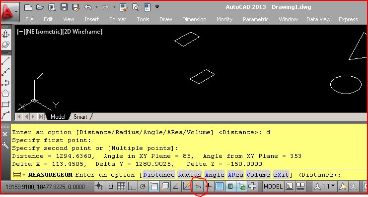

rkent Posted July 14, 2012 Posted July 14, 2012 With 2013 measuregeom needs the DYNamic input on to work as expected, I think in 2012 it would show regardless of how DYN was toggled. Quote
Dadgad Posted July 15, 2012 Posted July 15, 2012 With 2013 measuregeom needs the DYNamic input on to work as expected, I think in 2012 it would show regardless of how DYN was toggled. I am not finding that so on 2013 vanilla. I just checked, as shown with dynamic UCS and dynamic input both turned off, and it worked fine, and in 3D isometric no less. System variable difference perhaps? Quote
rkent Posted July 15, 2012 Posted July 15, 2012 When I wrote "as expected" I meant in 2012 it would show on screen in dynamic mode regardless of the DYN setting, in 2013 one must have DYN on to show dynamically while using measuregeom. Quote
