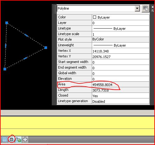

If the object which you are checking is CLOSED, then the area of that object, when selected
will be displayed in QUICK PROPERTIES, as shown in the image.
I have circled the QUICK PROPERTIES icon in red, you can turn them on or off here.

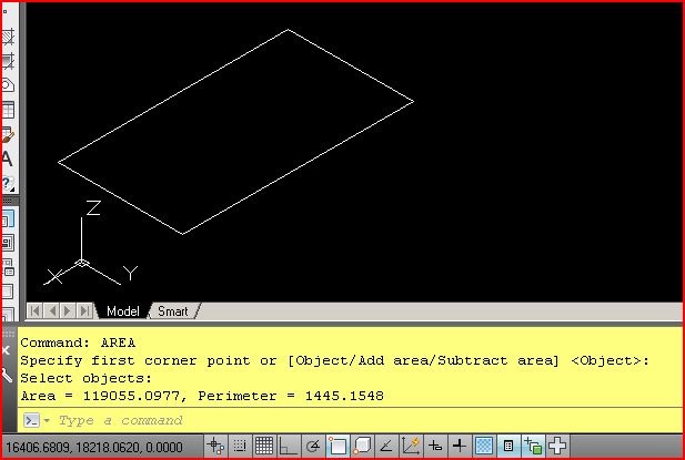

This is what happens when I use the AREA command at the commandline.
You need to then hit ENTER, if you want to select an OBJECT.
Then select the OBJECT, and if it is CLOSED, then you should see a result like this.

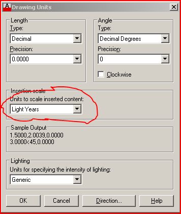

Issue number one would be that the drawing is not done to 1:1 scale, which is a bad way to start.
In modelspace the drawing should be done FULL SIZE, doesn't matter what you are drawing. Which is why in dimensions
you see units of measure like LIGHT YEARS. Yes even when drawing the SOLAR SYSTEM you would draw it full sized in modelspace.
Yes, that is right, you probably wouldn't print it fullsize, you would scale it to an appropriate size from your paperspace viewport.

By entering -DWGUNITS at your commandline you could determine what the drawing units in use in the drawing are.
6 represents METERS, which you will see after you open the DRAWING UNITS dialog box with the -DWGUNITS command.
