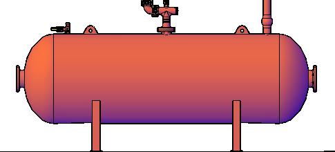

I guess I'm one of the "most". Here's my reasoning:
I like to draw tank/pipe endcaps reasonably accurately, and they're not typically shaped as hemispheres, therefore a polyline arc segments aren't the best choice. Ellipses are a more accurate reprsentation, but you can't REVOLVE a ellipse directly into a Solid, so I do the endcaps, SURFSCULPT them into solids, then union them onto the tank body (cylinder)
