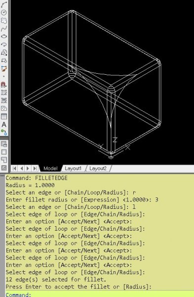

A couple of ways to go.
One would be to draw the TOP view including the radii on the corners in the XY plane.
Using the PRESSPULL command pull it up the Z axis to give it depth and transform it into a 3D solid, which already has four radiused edges.
Watch the EXTRUDE & PRESSPULL video tutorial on this site (http://www.cadtutor.net/tutorials/autocad/extrude-and-press-pull/) for clarification.
Pay extra attention to the PRESSPULL command as it is much more powerful and faster than the EXTRUDE command.
Then you can use the FILLETEDGE command to put the radii on the top and bottom corners of your 3D solid. :wink:
In order to better see what is going on in modelspace when you are modeling I would suggest that you use an ISOMETRIC
perspective chosen from your VIEWS toolbar.
Look at the commandline history I have attached in the image of the box which now has radiused edges with radius of 3, all the way around.
I didn't PRESSPULL this one from scratch as described above, just slapped some radii on the edges of your existing box.

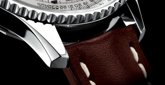

Unfortunately I wasn't clear about what I was asking, but now I am attaching a picture which shows what I'm trying to model.
The drawing file I sent in my first post was just an example, and yes, all three arcs have different radii, they are not tangential to the faces edges because... it was my mistake...
I want to model an watch case bracelet horn like the one shown in the picture below, is it possible with AutoCAD 2008 ?

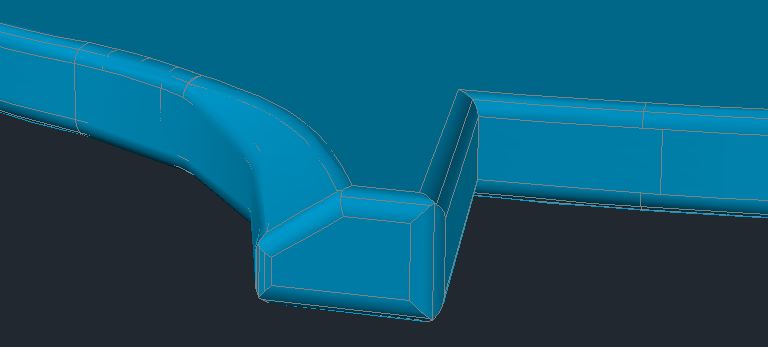

I would use LOFT.
Yeah that's what I thought too, tried that first,
but I wound up using PRESSPULL, SLICE (surface option) & FILLETEDGE.
Lots of room for improvement, but the basic concept holds water. :beer:

Playing around with this will probably help you understand how I did what I did.
I drew the shape of the watch in TOP view, then used PRESSPULL to give it depth along the Z axis.
I then defined the area where the bezel has that nice chamfer and created a SURFACE.
I then used the SLICE command and selected the SURFACE option so that I could use that SURFACE to cut off the little bits which are pulled out to the sides.
You will also see the surfaces which I used in the SLICE operation between the cut off pieces and the bezel.
Then I used the FILLETEDGES command.
You will see 2 different details where the strap horns meet the bezel, I prefer the left hand one, as the additional inside radius cheapens the rest of the watches subtle design (not mine, but the one in your picture).
