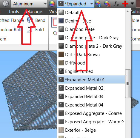

I've Got A Plate In My Head but I can't remember where I lost it. Unless I am dreaming I have used "expanded metal" and "tread' or "diamond plate" in Inventor 10 or 12. Now, I cannot find either in 13.
I've perused the other posts where you can make your own, I just want to make sure that I am not imagining the whole thing. Did Inventor used to have these materials in the material libraries? Can it be found in Inventor 13?
What happens if I open an Inventor 12 drawing that had used diamond plate or expanded metal? Will the materials be superceded by a different material?
My head hurts. It's that darned plate...
Keep in mind that Materials (properties) and Colors/Textures (cosmetic) are two different things.
They added a Material selection in the same location where the Colors/Textures used to be and moved that over to the right.
Dr. Mathers adjusted the plate in my head and I'm doing just fine now.
