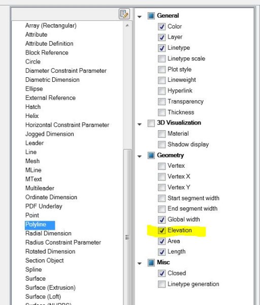

Select a CIRCLE, POLYGON or whatever type of object, the properties of which you want to see.
If you have QUICK PROPERTIES turned on, right click anywhere in the border of the box.

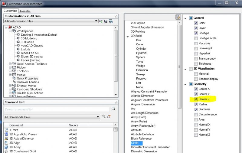

Choose CUSTOMIZE which will take you to the following images.
Here you can specify whichever attributes you wish to include in the QP display for that particular type of object.
For the CIRCLE you can see that elevation is not an option, but CENTER Z is, use that instead.

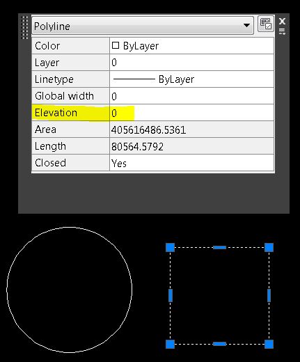

For a POLYLINE you can choose to display the elevation by checking the box.
SAVE your changes, or APPLY, which will let you then choose another type of object and set it as you wish.
