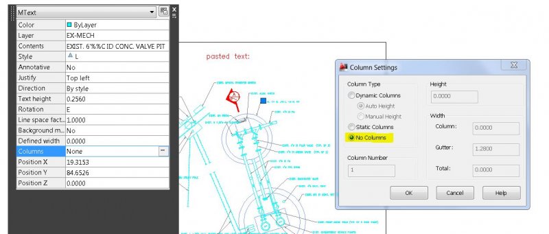

You have DYNAMIC COLUMN style selected, which makes your defined width unavailable for change..
If you turn that off, as shown in the image you will be able to edit their widths enmasse, or individually. :)
