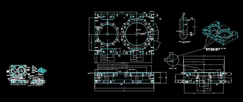

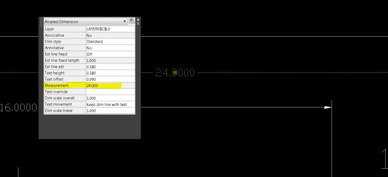

I have a drawing from an outside source which was not drawn to scale, and dimensioned in MS.. When trying to scale the drawing to 1:1, the dimensions lose their contents. When looking at the properties, the contents of the override do not jive with what is actually shown, and any attempt to edit, move, copy/paste, or scale the dimensions will delete the contents. I have not come across anything like this before. Does anyone have an idea??? Drawing attached...

You need to scale the whole drawing in modelspace up by a factor of 4, as it is not drawn 1:1.
The dimensions are neither associative nor annotative, which is why you are confused, they are drawn to OSNAPS, but they are not attached to them.
Also the horizontal dimensions are ALIGNED dimensions which is a strange choice, most folks would have used a regular ROTATED DIMENSION for those.
I hope that helps you get a handle on it. :)
As you can see in the image, when I scaled it up by a factor of 4 the dimensions scaled right up with it, no problem. After which they all showed the actual measurement values.

Yes but notice how the information in the dimensions were lost when the drawing was scaled? The tapped holes have notes attached that are no longer there upon scaling... Thats what is confusing me

If you explode those diametric dimension overrides before you scale the drawing up, then they will become text and when you scale them they will be maintained (strange, but legible).
Very strange dimensions, they don't even show a DIMSTYLE in my quick properties palette. :beer:

As Dadgad mentioned, explode will save the text, but I would explode a copy and then copy/paste the text into the dimensions using DDEDIT.

Im running Mechanical... Thats what I am going to do though. Explode and copy/paste. Thanks all for the advice!
