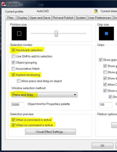

Dadgad Posted July 20, 2012 Posted July 20, 2012 Hang on guys, I may have found my problem. Look me experiment a bit more. Thanks, BWSwede Welcome to the forum. I know just what you mean, that is how it is set up on my system too. Life is too short to waste all those uncalled for clicks. Confirm your SELECTION tab settings in OPTIONS look like this, windowing style BOTH-AUTOMATIC DETECTION is alright also. Whoops, you are on 2002? I started in 2008, maybe the information will still help you, hope so. Might it be a PICKADD need to be set to 1 issue? Quote

Dadgad Posted July 20, 2012 Posted July 20, 2012 I thought using 'r' and 'a' to remove / add selections only worked after a command had been started, at least that's the only way I have used them. Yes, you are correct, they are used transparently midcommand. As it is working on my system, although I am using 2012, in the way which you are trying to reconfigure I thought that seeing my current settings from the SELECTION tab might shed some light on your problem. Quote
Dadgad Posted July 20, 2012 Posted July 20, 2012 The availability of R & A is only midcommand. once you have hit ENTER to complete the selection, you no longer have those shortcut options at your disposal and will need to use the SHIFT option as suggested by BillBorec, or use S, as you mentioned in your earlier post. Pardon me if I am mistaken, but are you sure you have not forgotten the sequence. After hitting ENTER the command modifier shortcuts no longer are valid. Quote

Dadgad Posted July 21, 2012 Posted July 21, 2012 Folks,Thanks for the input (Dadgag I believe you confused another poster with me). What is not working now compared to before, is the ability to add or remove to a set (using "a" or "r") without a command active. No, I didn't lose sight of the thread. (DadgaG? You must have been talking to my wife.) What I see is that is how mine has always worked. While selecting and defining the selection set, you have these two command modifiers available, but only until such a time as you have completed the selection set with the right click. They appear to be part of the SELECT command which runs inside of other MODIFY type commands, and cannot be accessed directly otherwise, except by using the SELECT command. They can also be accessed when using the P for previous selection set, but then too, that would be while you have a command running. I'll be interested to see what SLW210 comes up with. You sound quite sure this was not always so. I started in 2008, but robdraw seems pretty sure on this point, and he is using 2002. Quote
