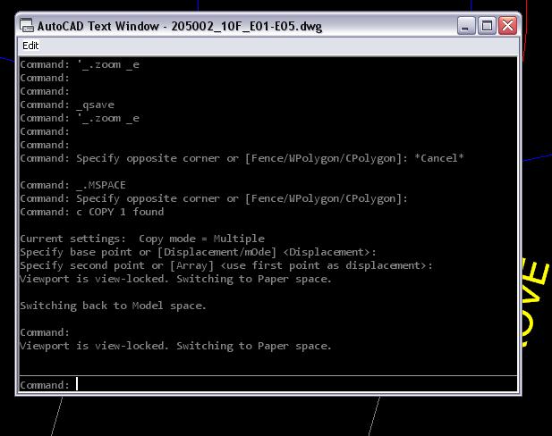

I recently got vanilla AutoCAD 2013 (XP) and am now having a problem where it will randomly switch to paperspace while i am working in a viewport usually during a command. I have searched the entire internet apparently no one else has ever had this problem. If anyone has any ideas I would be appreciative.

It would be helpful to see your commandline history,
which would show us what you were doing when this happened.
The next time it happens use F2 to open your commandline history window
and copy to the clipboard the last 12 lines or so, which should be more than enough
to show what you were doing when it happened. Then post it back into this thread to help us to help you get it sorted out.
Thanks Dadgad
Seems that it's doing the usual locked viewport pan zoon thing except it cancels the command and doesn't switch back to model space.

When it says switching back to Model Space I believe that it is merely activating your locked viewport, right?
I am trying to work in modelspace. It does not seem to matter which object i am selecting or which command if any is active. When I pan or zoom in a locked viewport it does not always automatically switch back to modelspace and any command that is running gets canceled.
