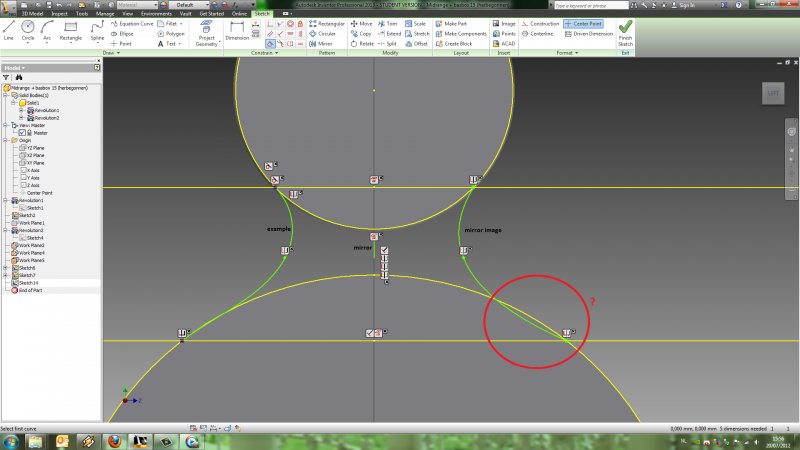

zalig Posted July 20, 2012 Posted July 20, 2012 I try to mirror a line (spline) who is tangent to 2 circles. I need these lines to use as rails for do a loft later on. When I do this, each time the mirror image isn't exactly like the example. I putted a photo in attachment to make things clear. What am I doing wrong? (excuse for my bad Englisch) Quote
SLW210 Posted July 20, 2012 Posted July 20, 2012 Try to insure you are mirroring in a straight line. And make sure you are MIDDLE between the two points. Quote
JD Mather Posted July 20, 2012 Posted July 20, 2012 Mirror splines can sometimes do that. There is a better way. Mirror the points and create the spline twice. Attach your file here. Quote
zalig Posted July 21, 2012 Author Posted July 21, 2012 I'm sure that te mirrorline is in the middle between the points. Also becaus the points of the mirror image snap to the right points, just the spline isn't right. I tried to make the spline by mirroring the points but unfortunately the result is the same. I attached the drawning. Midrange + basbox 15 (herbegonnen) versie 2.ipt Quote
JD Mather Posted July 21, 2012 Posted July 21, 2012 Sketch1 is unconstrained and has an extraneous point. Work Plane1 is a uneeded duplication of the XY Plane. Sketch4 is unconstrained. There are no mirrored sketch points for spline like you claim. There are no mirrored splines. Did you attach the correct file? I recommend you start here http://home.pct.edu/~jmather/SkillsUSA%20University.pdf Quote
zalig Posted July 21, 2012 Author Posted July 21, 2012 Indeed, I attached an older version of the drawning. Can you please look al last time to these new attachment? The duplication of the xy workplane is a mistake, but I discovered it later. Thanks in advance. Midrange + basbox 15 (herbegonnen) versie 3.ipt Quote
JD Mather Posted July 21, 2012 Posted July 21, 2012 Sketch1 is still unconstrained. Your mirror line in Sketch14 is not constrained to the origin. I would go back and read that document agian and start over. After you have given it a bit of effort I will recreate the part with the technique that I would use. Quote
zalig Posted July 23, 2012 Author Posted July 23, 2012 I restarted with the help of your course, I still get stuck with the spline, but now it works by mirroring the point. Hero! Thanks. Quote
