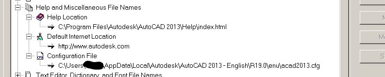

Dadgad
This is not the architectural desktop, but 2013 vanilla ....
Share this post
Link to post

SLW210
Open Help and see where it is opening....
[ATTACH=CONFIG]36173[/ATTACH]
