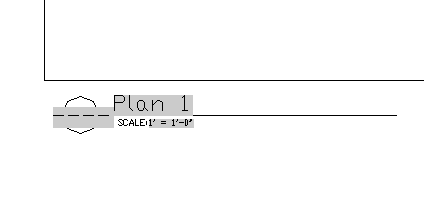

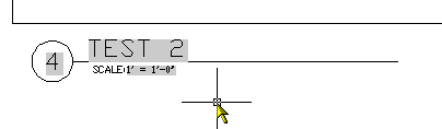

rkmcswain Posted November 4, 2008 Posted November 4, 2008 ive printed and read that entire thing and it still doesnt make sense. any other ways of explaining it? I'll try. Your sheets in the sheet set are the drawings you are going to plot out and submit. Other drawings might be considered "Reference drawings". (Let's say one reference drawing is a DWG file full of details in model space. Also assume that each detail has a named view created for it.) Now add this reference drawing to the "Model Views" tab. After doing so, the named view will show up under the drawing. Now open a sheet in your sheet set. Let's say it's a sheet full of details. Now on the "Model Views" tab, right click on a named view and choose "Place on Sheet", and then do so... Now switch to the Sheet Views tab. You will see the view you just placed. Right click on it, and choose "Rename and Renumber" and then give it a name and number. Now open a different sheet in your sheet set. Right click on the named view in the Sheet Views tab again, and this time choose "Place Callout Block" (you need a callout block defined in your sheet set). The callout block (if properly defined) will include the named view "Name" and "Number". Now from this point on, if you change the name and number in the SSM, the callout block will update. HTH... Quote

rkmcswain Posted November 4, 2008 Posted November 4, 2008 I'm not sure how to explain any further without us both looking at the same screen at the same time... Try this. Follow along as slow as it takes. SSM is a bit confusing, but once you "get it" - it's not hard at all. * Open this sheet set: C:\Program Files\AutoCAD 2009\Sample\Sheet Sets\Civil\Civil Sample Sheet Set.dst * On the Sheet List tab, double click on sheet 21 to open it. Open sheet 20 also, but make Sheet 21 current. * Now switch to the Model Views tab. If nothing is shown there, then click on "Add new location" and add the directory "C:\Program Files\AutoCAD 2009\Sample\Sheet Sets\Civil" * Next, click on the [+] sign next to "Site Layout Plan". You will see four named views that exist in that drawing. * Right click on "Plan 1" and choose "Place on sheet" and then place it on sheet 21. (Don't worry about the location...) * Now zoom to the lower left corner of the view and notice the detail block. * Now switch to the "Sheet Views" tab. Notice that Sheet 21 is listed now. That is because an inserted named view was placed there. * Now switch drawings so that Sheet 20 is current. * On the Sheet Views tab, under "21 - Erosion Control Plan", it says "Plan 1" -- right click on that and choose Rename and Renumber. Give it a number of 8 and name of "MY TEST" * Now it will say 8 - MY TEST in the Sheet Views tab. * Right click on this and choose "Place Callout Block" and then choose "Callout Bubble". Insert it on sheet 20 (anywhere...) * Zoom into it and notice it looks like this... * Now right click on the "8 - MY TEST" again (in the Sheet Views tab) and choose Rename and Renumber again. This time change it to 4 and "TEST 2" -- Regen sheet 20 and the 8 will change to a 4. The 4 is the "VIEW NUMBER" and the 21 is the SHEET NUMBER that the view is found on. * Now switch back to sheet 21 and regen. The detail block should look like this. So now... you have a view on sheet 21 and a callout on sheet 20. All you have to do is rename and renumber the item in the SSM (on the Sheet Views tab) and both the view and the callout are automatically updated. HTH Quote
