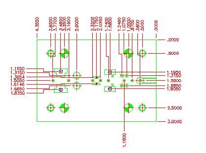

I haven't done this in several years, and my notes are apparently incomplete.
Enclosed is an image of the type of ordinate dimensioning that I want, and also my faulty notes. Maybe someone here can add the missing pieces. When I follow my notes, for some reason the UCS is displayed, whereas in the past it wasn't. I am using Version 2000 if it matters.
Thank you,
Gotchy
Notes:
Tools/New UCS/Origin
this yields small selection square
select top right hand corner, for the zero point, then from the Tool Bar:
Dimension/Ordinate, to mark the corner with zeroes.Image00256.jpg
