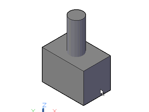

>>> that is my computer and that is the vedio i recorded from it .. please watch it to know what iam talking about

>---- that is my computer !

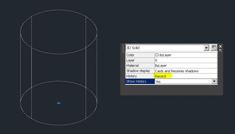

If you look at the image you will see the QUICK PROPERTIES palette displaying attributes (which has been customized to display those attributes which I typically might want displayed for a Solid),
describing relevant information for the cylinder which is selected.
In addition to having your SOLIDHIST to 1, you will notice that I have selected in the palette to RECORD, the default is NONE.
Once you do that it will all start to work for you.

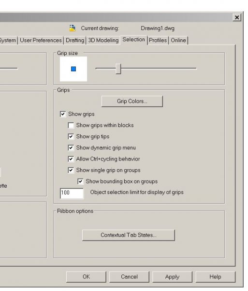

I have also attached the settings from my OPTIONS > SELECTION tab, which may help you get your grips display sorted out.

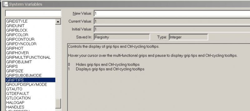

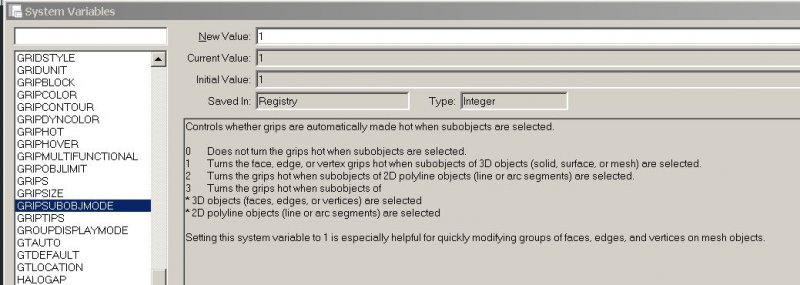

If you enter SYSVDLG at the commandline you will be able to access all of the system variable options, which can be quite enlightening.
There are so many ways commands and tools can be used other than the default settings.
This images show just a couple of the GRIPS system variable settings.
At any rate, I would strongly suggest that time permitting you go through these system variables (meaning the GRIPS ones here) to set them as you would like them.
The GRIPMULTIFUNCTIONAL variable would also be of interest to you. :)

thanks alot for ur effort , that is great work .. i really appreciate it .. but i have the same settings in the option menu and the SYSVDLG .. everything is correct as i think
