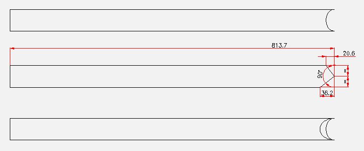

Rynz Posted July 28, 2012 Posted July 28, 2012 Okay so I designed these pipes that intersect each other in AutoCAD but that program doesnt seem to do much else other than drafting. I want to open a pipe design so i can print it out, paste it on a real pipe and cut the end out. It's pretty much sheet metal development. Attached is one of the many pipes. Can someone please point me in the right direction? I have Autodesk Inventor FUSION 2013. Does that have any such features or do I have to get the Professional version? G.H.dwg Quote

Rynz Posted July 28, 2012 Author Posted July 28, 2012 My apologies for ignoring that other tread, I just thought since AutoCAD wasn't an issue I should post in a Inventor section. As far as I know I think the pipes will be cut using gas or plasma cutters. I'm pretty clueless about that. The head machinist at the company says I just need to get him the profile to cut and leave the rest up to him. He's pretty good with 20 years of experience so I'm not worried about that. They'll trace the paper print outs on the pipes and than go ahead with cutting it from what I was told. Quote

Rynz Posted August 6, 2012 Author Posted August 6, 2012 I've downloaded Autodesk Inventor Trial but it keeps freezing on me every fews minutes after I open my Autocad files in it. I'm officially stuck and have no clue what to do. I'm even willing to pay someone to help me out with this last step since I have all the design done and all i need is to 'open' a pipe and print it's developement out. I live in Sydney. Anyone know of any organisation or individual that offers such services? Unless if someone on this forum wants to do it. I'll definitely pay! A sample is attached. Drawing1.dwg Quote
