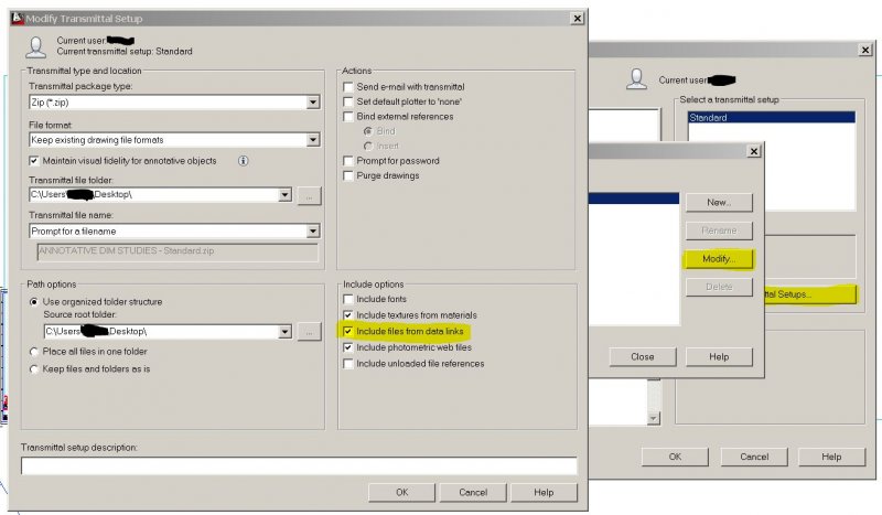

You should take a look at ETRANSMIT, which is one of the options listed in your beloved MENU BAR, if you click on FILE, or on the APPLICATION button, under PUBLISH. There are a lot of available options, once you dive into it, you can probably create a new transmittal setup type however you need it.

I thought an linked xls file became an embedded table if the original xls file couldn't be found but could be re-synced at a latter date. You are probably right about file size but I have had lots of issues of losing lines with paste special in the past so its a no brainer for me.
