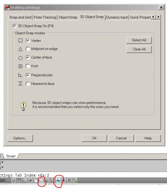

Dadgad Posted July 30, 2012 Posted July 30, 2012 If you are trying to Object Track in 3D I would suggest you enter PERSPECTIVE at the commandline and set the variable to 0. In that way you will be in Parallel view. In 2011 or 2012 3D OSNAPS were added to the program, which are what you should be using, and I would suggest an ISOMETRIC perspective, so that you can really see what you are snapping to and from. Turn off your 2D OSNAPS, as they will make it harder to use your 3D OSNAPS. You may find it helpful to turn on your DYNAMIC INPUT too. In the image you can see both the 3D OSNAP and DYNAMIC INPUT icons are circled in red. You can also turn your DYNAMIC INPUT on and off with F!2. Quote

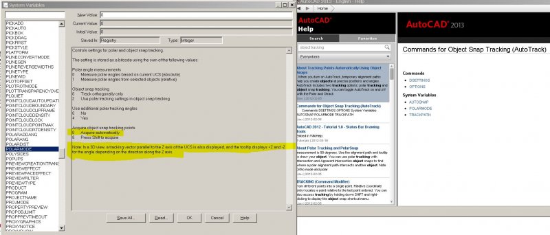

Dadgad Posted July 30, 2012 Posted July 30, 2012 If you look at the highlighted areas in the image which is from the SYSVDLG (system variable dialogue) you might get some hints. Quote
Mena__99 Posted July 30, 2012 Author Posted July 30, 2012 thanks man that is great advice .. but guess what ? .. i changed the Osnapz to 1 .. then back to zero .. and when i tried again .. it worked ...!! .. it might be just a bug because it seems that i didnt change anything ... maybe there is a refresh code that can fix that easly instad crying out here all day xD .. maybe regen or regan code could fix bugs like this .. altho i remmber closing and opeing the program many times xD Quote
