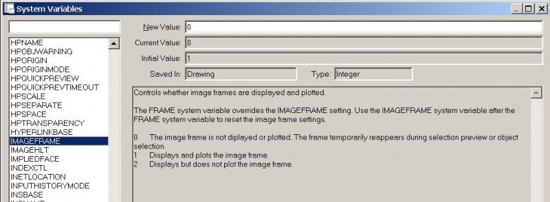

I'm aware that your system variables are likely different than mine, as I'm on a PC,
but these are the available system variables on my system.
Try setting it to 2, if you can, and see if that helps.

Sorry, I am not familiar with this dialogue box (I am learning 2013 mac, last used acad 2006 for PC).
Where do I find this dialogue box?
I am able to type in IMAGEFRAME and then 0 and that should, I think, be enough. It was with 2006 for PC.

Try using the SYSVDLG (stands for system variables dialogue) at the commandline, and see if you get the dialogue box.
