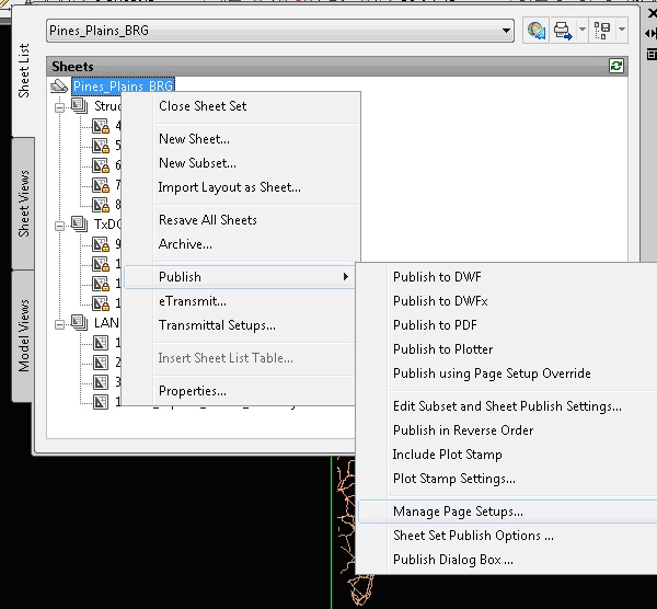

Yes, it will work. I have the default page setup in each layout set to the desired papersize. From Sheet Set Manager, I just right click on the choose Publish -> Publish to PDF. It plots each layout according to the page setup of that layout. (by the way, in Publish -> Sheet Set Publish Options, you will see additional settings like the multi-file, PDF output, include/exclude layer information....etc).

If the layouts are different sized sheets, they really need to be set in each layout...but you can set that from within the sheet set manager. You can also use page setup overrides, but that would be global for all sheets...so no alternating paper sizes. Try out the sheet set on a simple set of drawings...once you create it, it is very easy to explor the options available - to include publishing using the publish dialog box (so you won't loose anything you currently are able to do, but you'll gain a lot more options).
