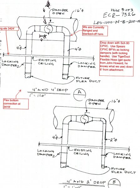

i was given this 2D example piece.
and was asked to recreate it on CAD.

You'll need to use the Line, Circle, Trim, Copy and/or Mirror commands. For completely straight vertical or horizontal lines make sure you have OrthoMode enabled. That's the F8 key on your keyboard. This can be toggled on/off.
You can use the MText command for all text. Set the font style, etc. via the Style command.
Are you going to make use of a paper space layout?
Make sure to set up layers for your geometry (the objects you are drawing) and your text. Do not draw everything on layer "0" in color: white.

You should create a layer for your viewport(s) and set it to "no print" in the Layer Properties Manager.
Your title block and border belong over in the layout and not in model space.
