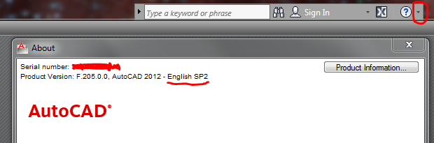

Just how did you come to find out the error was generated by a conflict between your graphics card driver and AutoCAD?
Are you current with all 2012 updates?

Look in the upper right hand corner of your screen. See that downward pointing arrow? Click on it. Then click on the "About" option. That will open a separate window. Your version of AutoCAD will be listed as well as any service pack (SP) information. See mine? I'm current with Service Pack 2. And you?
