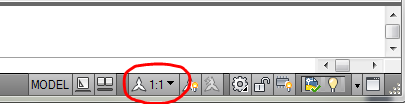

paulh31 Posted August 3, 2012 Posted August 3, 2012 If in Paper Space, entering into the viewport to zoom to a specific scale (factor), what is the easiest way to make sure I am using the correct scale factor? ie a calculation? for example say I wanted a scale of 1:20 or 1:100? thanks Quote
ReMark Posted August 3, 2012 Posted August 3, 2012 Selecting it in your Properties palette is one option. I don't see the need to use the Zoom > Scale any more. If you have your Viewports toolbar displayed you can select a scale from there too. Quote
ReMark Posted August 3, 2012 Posted August 3, 2012 Another option: look at your Task Bar (lower left-hand corner of your screen). You can also specify a viewport scale in Quick Properties too. Quote
paulh31 Posted August 3, 2012 Author Posted August 3, 2012 I'm with you, i'm getting confused with 1:500 being 2:1?! For whatever scale I want I can do it through the properties palette? Quote
ReMark Posted August 3, 2012 Posted August 3, 2012 See previous posts. If the scale is not on the list you can add it via the SCALELISTEDIT command. But I suppose you already know that right? Quote
