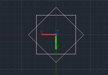

I drew the polar arrayed rectangle as attached and tried to trim the inside lines to create an octagon but i cant trim the object.
However, if i try the same thing without polar arraying ( i.e just by drawing the two rectangles similarly) it works. I would like to know what might be causing this.
Thanks!

I believe that if you exploded the array, then you would be able to trim the offending lines.
Seems that you are looking to create a star with 8 corners, not an octagon.
Up to my knowledge in AutoCAD 2012 you have associative arrays, so this seems to be the reason that prevents you doing that trim operation; try to use the classical command ARRAY instead or disable associativity feature if use the new ARRAYPOLAR.
There also seems to be a new command named ARRAYEDIT that may allow you to remove the associative behavior.
Thanks a lot!
I know i could have done it using simpler commands but the point was to understand why i wasn't able to trim the array. I am new to autocad so i knew there was something very simple i was missing out on. Thanks for the help, i have figured out the EXPLODE command as well.
