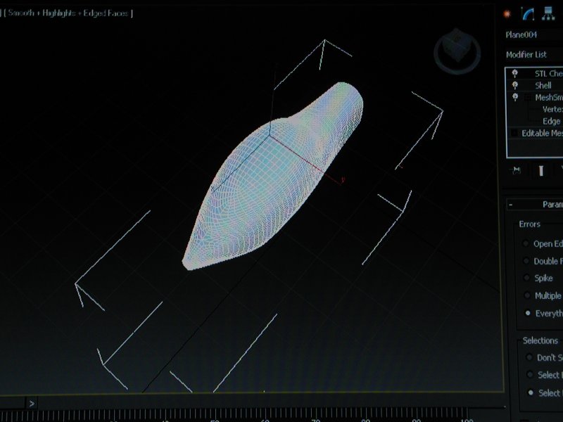

I have completed my object, mesh smoothed and built out the shell on the inside, applied stl check - no errors the first time, which was a happy surprise. Now I have sent the object to be printed but the 3D printer says it's too large, and I'm certain it is not. I think the problem is the white line "frame" around the object, which is too large. I've fiddled with this thing but can't understand how to made it the same size as the object. HelpDSCN9177.jpg please (once again) Thanks.
With the object selected, switch to vertex selection mode and look for stray vertices floating out in space. If you see some, select them and delete them.
Of course! I was wondering if it was something dumb like that. Thanks again.
