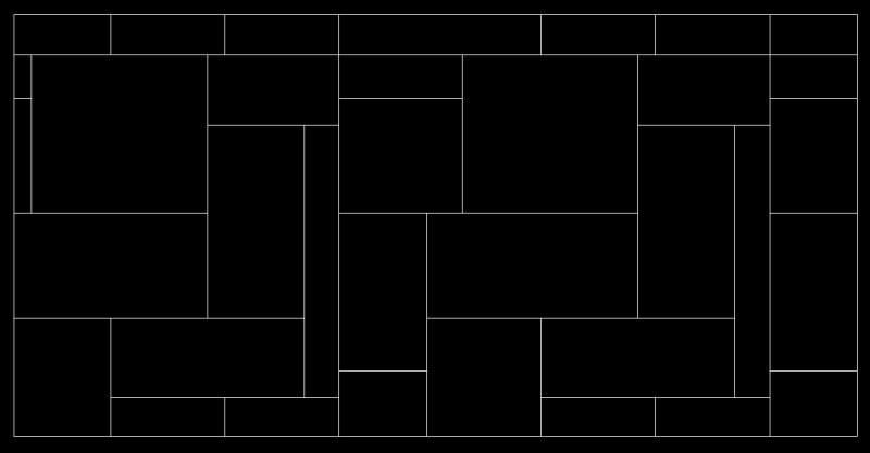

ReMark Posted August 6, 2012 Posted August 6, 2012 It sounds like you are looking for stone veneer that might be used on the facade of a house for instance as opposed to the type of stone found along side a stream. Am I right? Quote
ReMark Posted August 6, 2012 Posted August 6, 2012 This one is called "Biltmore". FYI - most patterns will repeat fairly quickly. If you want something that doesn't then you will have to create a custom hatch pattern yourself. You can write a pattern definition file or you can use two commands from Express Tools called Make Shape and Make Linetype. Quote

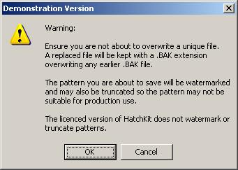

hugha Posted August 6, 2012 Posted August 6, 2012 Links to hatch pattern collections: http://www.hatchkit.com.au/HatLinks.php There may be an error in the hatch pattern file you are attempting to load. Make sure there is only one pattern definition in each pattern file, that the pattern name matches the filename and that there is a blank line at the end of the file. If you still face diffficulty please upload the file for analysis. Quote

hugha Posted August 8, 2012 Posted August 8, 2012 No way I can decypher what you all are doing with creating hatches, however I did find this http://www.hatchkit.com.au/download.php I had no success, but it could well be USER ERROR as the hatches looked great, loaded great and were done in an instant...just when I went to use them in AC in a real drawing, they were distorted.... I am NOT knocking the software....I still thnk its USER ERROR. Has anyone else tried it? Be aware the HatchKit Demonstration available from that link adds a watermark to the patterns it produces. The licensed version does not. Quote
