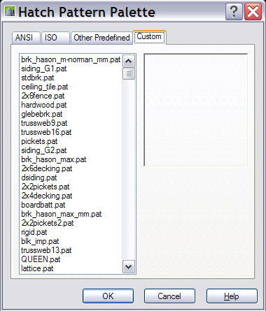

i have a slew of individual custom hatch pattern files (that's i'm pointing to a directory in the support file search path) and am just wondering how does autocad sort these in the hatch pattern palette custom tab...
as you can see in the attached image my hatch patterns are not sorted alpha/numerically...any tips on how i can name the files/description in order to do so...
here are a few pattern header example for your reference (in the order as they appear in the hatch pattern dialog box):
*brk_hason_m-norman_mm, hason brick metric norman metric
*Siding_G1, 4.5" Face 1" Gap
*stdbrk, standard brick
*ceiling_tile, 1 to 2
etc...
so, as you can see, there doesn't seem to be a sorting heirarchy...
any thoughts would be appreciated...

Hey hazardman
I tried this by creating a few of those patterns in a random order and the list sorted fine. See attached. I wonder is it down to the way the operating system is sorting the files. If you make sure that the files are sorted in the folder 'by name', does this fix the problem?

Have you tried exploring the MAXSORT system variable :unsure:
yes, i have already increased this variable to 6000 (i had it at 4800) without better results...
