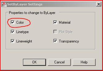

What about SETBYLAYER command?

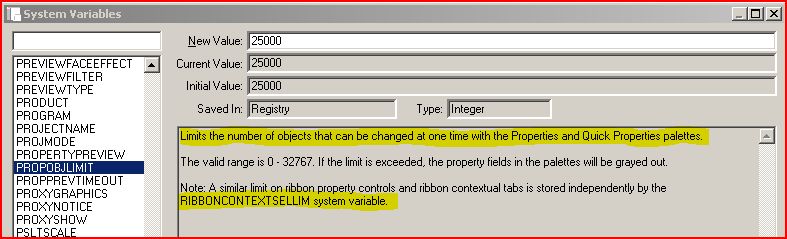

Are you trying to change these in PROPERTIES perhaps?
It might be because of the PROPOBJLIMIT system variable, as shown in the image. :)

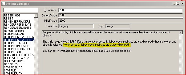

Wait a minute, is that a workaround possibly in the RIBBON CONTEXTUAL SELECTION LIMIT setting?
That sounds promising Blackfish! :beer:
Interesting. I tried the ribbon one and it still had the same problem for me.
At least increasing it to 32000 would be quicker if I ever need to use it again.
SETBYLAYER was added in R2008, so use that or the good old CHANGE command.
