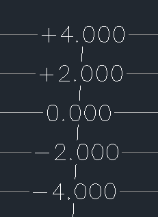

First off, very new to Civil and autocad in general. I'm doing hydrographic surveying and our default standard is for numbers that are below sea level or MLLW we post values with no sign. so a "20" means 20' under water. For stuff above water, it would look like "+20". Well, we have styles for all out point files to make this work but for our contour lines, we do not. There is a default option of "sign negative '-'" which is completely the oppisite of what I want. I need a "sign positive '+'" option. There is also a "sign always (+-) option which is what we might be stuck with, however, USACE doesn't like that. Again, I'm really new to this. I played around with a few thing, tried changing to
hoping that n=negative and a p=positive might fix it. Nope, not the case. Again, please dummy down any possible solutions. I'm pretty sure we could just edit it but these values do change as they are building stuff and would like to keep the dynamic aspect of it still working.

That did give me a + in front of my positive elevations but it also added a + in front of my negative elevations.
I need the negatives which are to the right to have no sign. if you look at the red numbers, it needs to match that. No sign means it under water.

Sorry but I actually need no sign for negatives. In the hydro world of things, no sign means negative. Don't ask me why, it's just backwards from the rest of the world. if you look at the red number from the pic above, you will see numbers with no sign, that's actually underwater or what we call MLLW for that area. It gets really confusing at times and clearly not the norm at all, if it was even close, they would have a Sign Positive (+) option in addition to the Sign Negative (-) option.
Example of what I want/need it to look like.

I have seen this done before.
We are going to disply the "+" sign using text. It sounds wild, but it does work.
Find out what text height would work. (The thickness of the + sign line.) It will be fairly small.
Creat an custom expression.
What we will use this for is to determine if the text that we use in the "plus sign" will be shown.
 [size=1]IF({Surface Elevation}<0,0.000000000000000000000000001,*TEXT HEIGHT*)[/size]
This expression basically says that if the surface elevation is less than zero, than it will produce that tiny number. If it is higher than 0, it will display the text that will make up the plus sign.
In the contour label editor, you will add 2 new text components. These will make your "plus sign". (I would use a series of "I"'s or something like that. In the text height box, select our expression we made.
Now go and test it out. The negative numbers will still ahve that "plus sign" but it will be soooooo smal that you will never notice it.
I hope all of that made sense!
