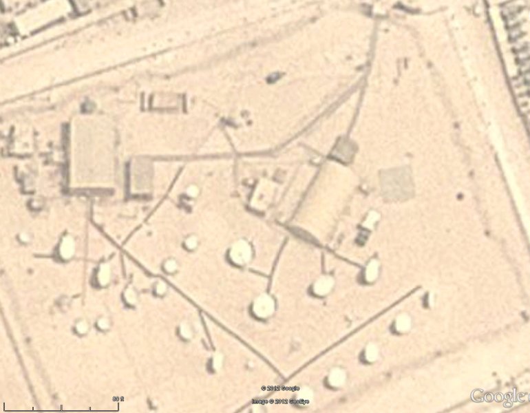

I am trying to draw on a screen shot from Google Earth. The image has a scale legend that has a measure line that is "80ft". I try to do a scale>reference to make my line equal 80 ft but instead the line I create is "2.75 inches". So I am trying to create a scale that equals what my screen shot is. Does this make sense?GoogleEarth Screenshot.jpg

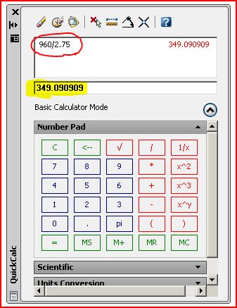

Scale it up using the SCALE FACTOR displayed in the calculator image. :)
Edited by Dadgad
Thank you so much!! I imported the screen shot at 349.090909 the scale and it worked!!

I have frequently used Google screen shots with a scale legend, and have no trouble scaling up by reference. Perhaps your technique is not quite right.
I draw a line on top of the scale legend, and then scale everything (screen shot image and line) about one end of the line, reference length is from one end of the line to the other, and the new length is 80. No need for calculation.
I use this same method also and don't have any problem with it.
Make sure you are scaling the image, not scaling the 80ft line.

Eldon, can you run me through you method a bit more in depth? I understand what you are saying but do not know how to execute.
Without giving an in-depth tutorial, I am not sure if I can add anything to my previous post.
You are familiar with drawing lines, using Osnaps and zooming in and out? and read the command line.
