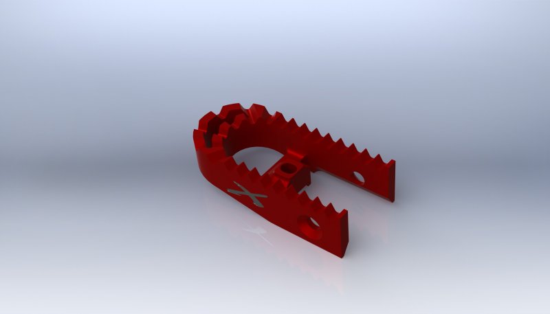

Im trying to do a model of a footpeg widener for my motorbike and having trouble to do an extruded cut for the pegs...
What a want to achieve is a "swept" cut with a sketched profile but in a 90degrees angle of the path line.
Hard to describe but I posting a photo so you can see what i want to do... :)
The ORANGE field is my sketched profile, that i want to follow the GREEN path. BUT following the direction of the arrows!
Is this possible?

Sounds like you want a Curve Driven Pattern (see the Help files).

Something like this? If so, follow JD's advice and use curve driven pattern. I would share my model but I'm running 2012 an noticed you using an older version. Let me know if your able to figure it out.

YES, that is exactly what I want to achieve!! :D Hmm... "Curve drived pattern" I have tried that too, but I dont know how to use it! I cant select the whole chain "path" and thats why I cant manage it to work.... Could you please give me a screenshot of your settings in that feature please?
By the way.... Is it possible to have different spacings between the cuts? Because in the curve it didnt look that pretty, so that would be a problem! :/

Here's a quick video showing Curve Driven Pattern and some of its options. There is no audio but I think you should be able to follow. Does it answer your questions?

Thank you so much!! That is so kind of you doing a video to show a newbie like me how to do it... But DAMN you are fast! Lucky for me there is a pause button... :P
I now have managed to do what I wanted, because of you! A BIG THANKS TO YOU BHAMZE! :notworthy:
My pleasure to help. Glad to hear you figured it out. Good luck on future projects!
