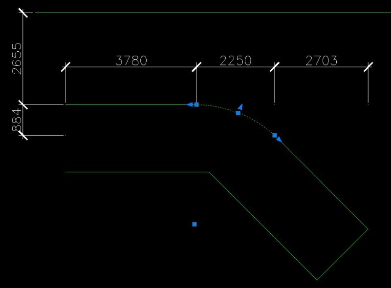

On another non-related question... I'm sure some of you do site drawings, how do you measure a curve? Some restaurants or cafes have a rounded serving counter, any tips on how you measure the radius to plot into autocad?

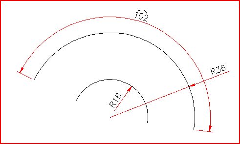

Use a RADIUS dimension, DIMRADIUS at your commandline, or select the icon from your dimension toolbar or panel.
You may choose to show an internal and an external radius dimension. :)

The Radial dimensions are probably the most appropriate, but then too there are times when you might want to show a measurement along an arc too.
You can see the ARC icon on the dimension toolbar to the left of the RADIUS icon, or use DIMARC at the commandline.
to add to the above post,
after invoking the DIMARC and selecting an ARC, you can type "P" for partial, and measure part of an arc if you need
I believe the OP is asking how to determine the radius of the curve on the ACTUAL serving counter to use in the drawing.
I would use a tape measure/straight edge or framing square if available.

sometimes it is easier to measure the straight bits or points in a cartesian fashion (like on a grid) and then plot the curve on after.

OR...determine radius by math.

I was actually talking about measuring the radius of a curve on the actual site, not in autocad.
Framing square looks good, but the curves in a restaurant are sometimes very big. I'm asking because there are always differences in the cad drawing when comparing to the actual site and I need to be fairly accurate on the dimension for fitting of equipments.

If the radii are larger, get a longer square or straight edge. If really large you can use a laser. Accuracy is money.
