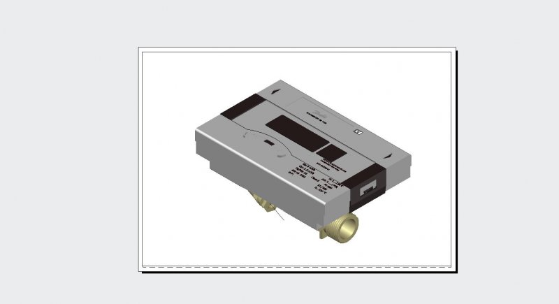

Nax Posted August 15, 2012 Posted August 15, 2012 Hi, I have a problem with changing solid face colour where the Solidhas a material assigned to it. I have searched the forum and not found any threadto help me I have drawn a meter and need to add text to the face. Trying to imprint the text is a mission and Idon’t seem able to make the text stand out. If I explode the text, Create asolid, Union the text, position the text on the meter face and union the textto the meter face the text takes on the colour of the material. I then try to change the colour of the textface and of course it will not change. The only way I can seem to change theface colour is to convert the solid to a surface which then defeats the object. As an interim solution to overcome my problem I have createdthe text and positioned it where I need it and then created a block to keep itall in place. It looks ok and providedthe block is not exploded it works ok but i am sure there must be a moreprofessional way of doing it. Does anyone have any suggestions? Regards Nax Quote

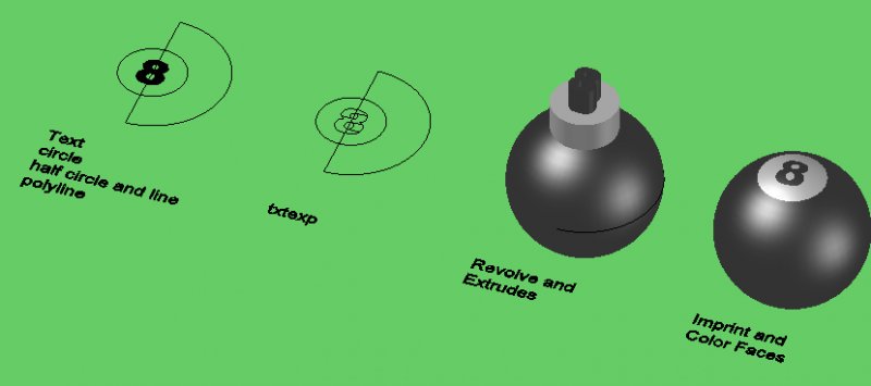

JD Mather Posted August 16, 2012 Posted August 16, 2012 (edited) I have now found a reference and downloaded a DWG file forthe 8-ball billiard ball. I could not find the tutorial explaining how the balland text were unioned to the sphere? Well what was the url - so I don't have to search for it. OK, I found this http://www.cadtutor.net/forum/showthread.php?43598-Purpose-of-Imprint&highlight=8-ball I thought I laid out the steps step-by-step. For the ball Revolve the Sphere Extrude the circle as cylinder and Imprint txtexp then extrude the text and imprint solidedit color faces and change the face color In later versions of AutoCAD you can skip the Extrude step before Imprint IF the face is planar. I think Tutorial 12 in my signature explains the process. Appling textures (materials) to individual faces is a bit different than changing face colors. You posted an image file rather than a dwg file - I am only familiar with editing dwg files in AutoCAD. Post your dwg file (or a representative example) here. Edited August 16, 2012 by JD Mather Quote

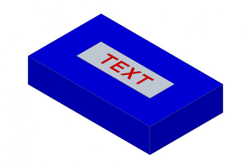

ReMark Posted August 17, 2012 Posted August 17, 2012 JDM's explanation worked for me. I have no use for this feature in my line of work so it isn't as though I use this technique every day. The one thing I did run into was I had to color the face of the individual letters and at the same time make sure to remove any unwanted faces (the white rectangle behind the letters) from the selection set. A bit cumbersome even with four letters but I'm sure there is a way around this too. Quote

ReMark Posted August 17, 2012 Posted August 17, 2012 Yes, the IMPRINT command was used with the lettering. In vanilla AutoCAD it can be found by clicking on the down pointing arrow found here on the Ribbon: Quote
