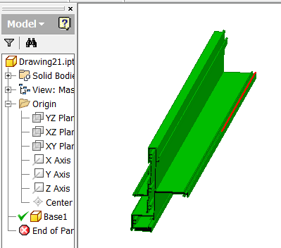

Bill Tillman Posted August 15, 2012 Posted August 15, 2012 I have an Inventor project which include aluminum extrusions. I'm still in the learning curve so I still fall back on AutoCAD's 3D capability to check my work. I made the attached part in AC 2012 and then went back into Inventor and tried to import it while making a new part. Must have done something wrong because after the import completed I couldn't see anything of it. Zoomed in and out but it appears to not be there. Can anyone check to see if this is possible. Can I take an AutoCAD 3D drawing which has all the machining and such shown on the ends and import it directly into Inventor and end up with a finished part? Drawing2.dwg Quote
JD Mather Posted August 15, 2012 Posted August 15, 2012 Works fine here. When it opens - two files are created, on blank file (delete) and a second file with the solid geometry off the screen (Zoom All). Proceedure File Open files of type AutoCAD *.dwg Click on the filename and Options (before opening) Set Options to Import Open in the Wizard set to 3D solids Quote

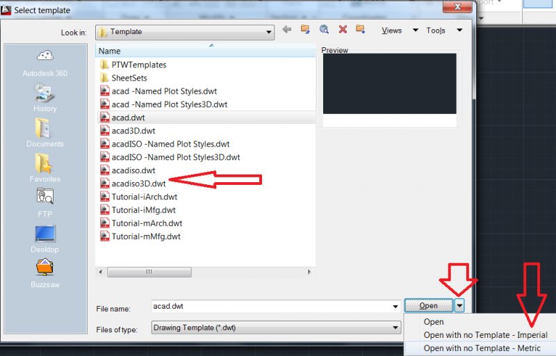

JD Mather Posted August 15, 2012 Posted August 15, 2012 Where do you think you set the units in AutoCAD? You must start from Metric template. or Metric - no template Assuming what you really did is start from Imperial (default) template and typed command Units, what does this say? - I checked your file by simply typing Dimstyle and saw that it was inch dimension style. Quote

JD Mather Posted August 15, 2012 Posted August 15, 2012 I will start this process again from scratch tonight... No need to start over - it is a simple Scale to make 1"=1mm Quote
SLW210 Posted August 15, 2012 Posted August 15, 2012 No need to start over - it is a simple Scale to make 1"=1mm -DWGUNITS will scale it also. Command: -dwgunits Drawing units: 1. Inches 2. Feet 3. Millimeters 4. Centimeters 5. Decimeters 6. Meters Unit for length <1>: 3 Drawing unit display formats: 1. Scientific 2. Decimal Linear display format <2>: Linear display precision <5>: Scale objects from other drawings upon insert? [Yes/No] <Yes>: Match INSUNITS to drawing units? [Yes/No] <No>: y ** WARNING: you have changed the unit for this drawing database. ** ** All new objects will be drawn according to the new unit, but ** ** existing objects will not change size unless you specifically ** ** ask to have automatic scaling occur. ** Scale objects in current drawing to reflect change in units? [Yes/No] <Yes>: Include objects in Paper Space? [Yes/No] <Yes>: Quote
