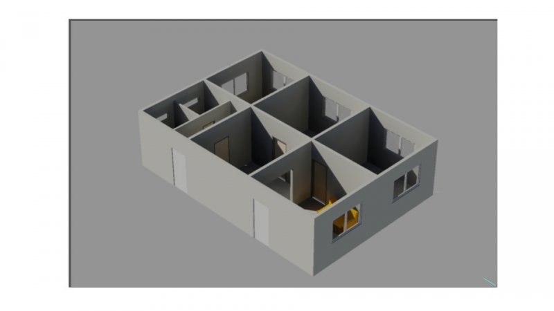

I have been able to successfully change all the windows, even effectively placed fanlight/top hung wndows + toilet + sofa and a few furniture. Sadly, there is no bed, wash hand basin, shower and dining table.
Do you know how I can add some of the missing architectural/structural elements i.e 450 mm high plinth, concrete step leading to the entrance doors ...
Thanks in advanced for your help.
Add the plinth by creating a new wall style.
Set the wall to a style that's closest to what you want, then select the wall right click. An options bar will appear towards the bottom of this will be something like "create new style and assign." A new dialogue box will appear. Give your style a better name on the"general" tab and add a new component in the "components" tab. This new component needs to be essentially the same as the existing one, but something like 25-50mm thick, topping off at 450mm above the base.
If you're got steps leading up to your front doors (TBH I'd probably just do these as 3D Solids/Mass Elements) you need to extend your walls downwards. Do this by seelcting your walls, right clicking, and choosing modify floor/roof line" followed by "modify floor line." You want an offset of of however deep your steps are (i.e. -300).

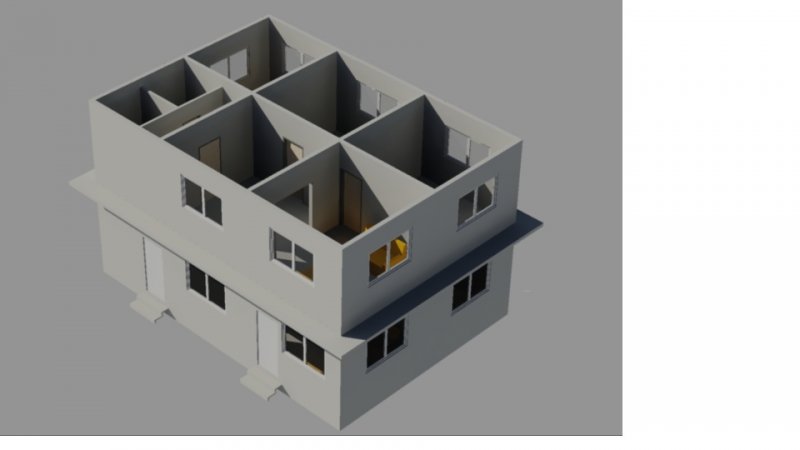

Thanks for your input. I have been working some of the missing elements using clues here and there. For example, I now have three sets of walls: plinth wall, ground floor wall and first floor wall. I have been able to do the steps through a little odd. I got additional blocks using Design Center.
I will try to do the same using your techniques. I would like to know why I am unable to apply materials to the wall or faces of the wall using CTRL. Also I need to have a bleam on top of the wall, column at the intersection, hard core filling below the concrete floor slab, decorative cornish to the slab...
I have seen little or no tutorials. Do you have any links available where I can get those missing lessons?
Here is the latest image of the project.
Thanks in advance for your help.
