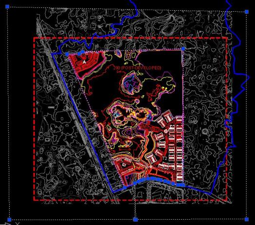

this picture shows two xrefs...one is inside the other, with the outer xref cut out.....its pretty simple
the object i have selected is the polyline used as the clipping boundary
